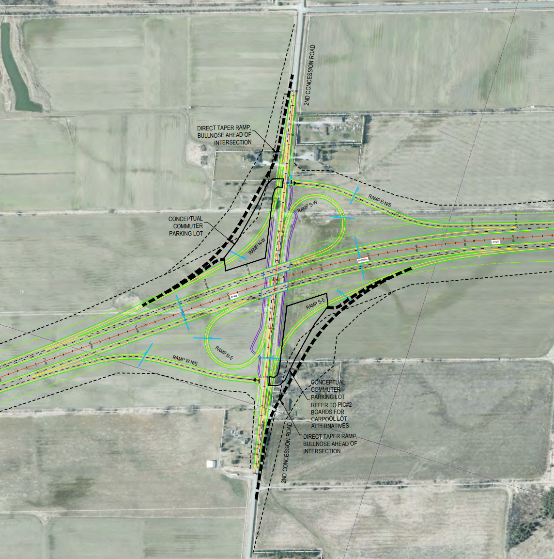

I thought I would start a thread for the Bradford Bypass as we don't appear to have one. MTO is currently out for public consultation on the preferred alignment:
  • Bradford-Bypass-Roll-Plans-HighRes-R_C.pdf
the wider the radius the higher the capacity, basically. These ramps are roughly similar in size to those built at the 407 / 404 interchange (SB404 > EB407 is a 525m radius ramp).
MTO actually picked a few of the smaller options for the interchanges, the initial design updates were contemplating 750m radius ramps for all 4 directions at the 400.. they ended up only doing one 750m radius ramp.
Generally I agree that they could probably be way smaller though. The 750m radius ramp in particular is wayyy too large. Drop them to 350m radius (similar to the 400 / 407 interchange) would cut the footprints significantly with a minimal impact on capacity.
