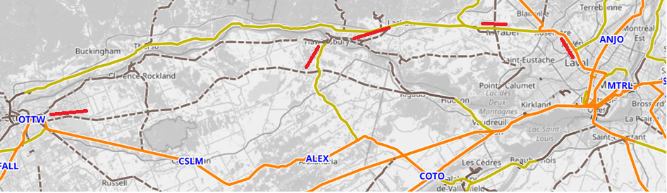

I'm talking about a route as outlined below in red dashes, using different ROWs. I think it's vanishingly unlikely. For example, I figure you would need a 3 km tunnel under Hawkesbury and the Ottawa river. At the end of the day, it's not really a longer or impossible route, assuming you can connect Gare Central to Parc with a new tunnel.View attachment 699021
I do like this route too though.
