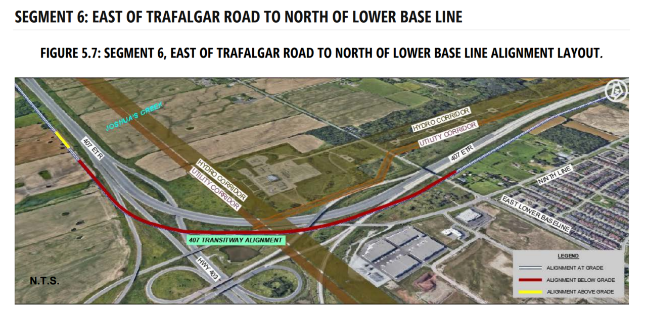

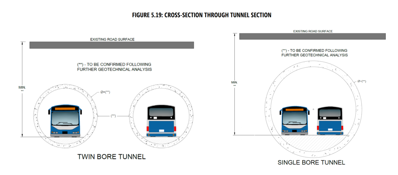

Interestingly, they included what looks to be TBM tunnel cross sections in the EA (pg 18 from https://407transitway.com/brantToHu...4 - EPR - 5 - Preferred Alternative - WEB.pdf ; all other page numbers in this post refer to this document unless otherwise specified.):

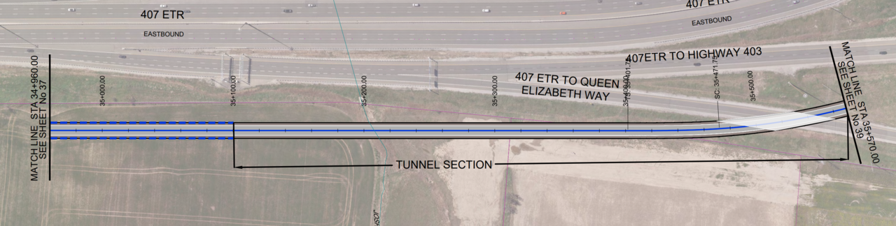

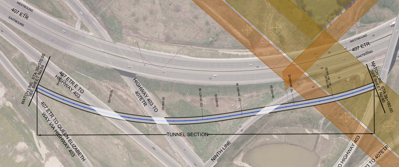

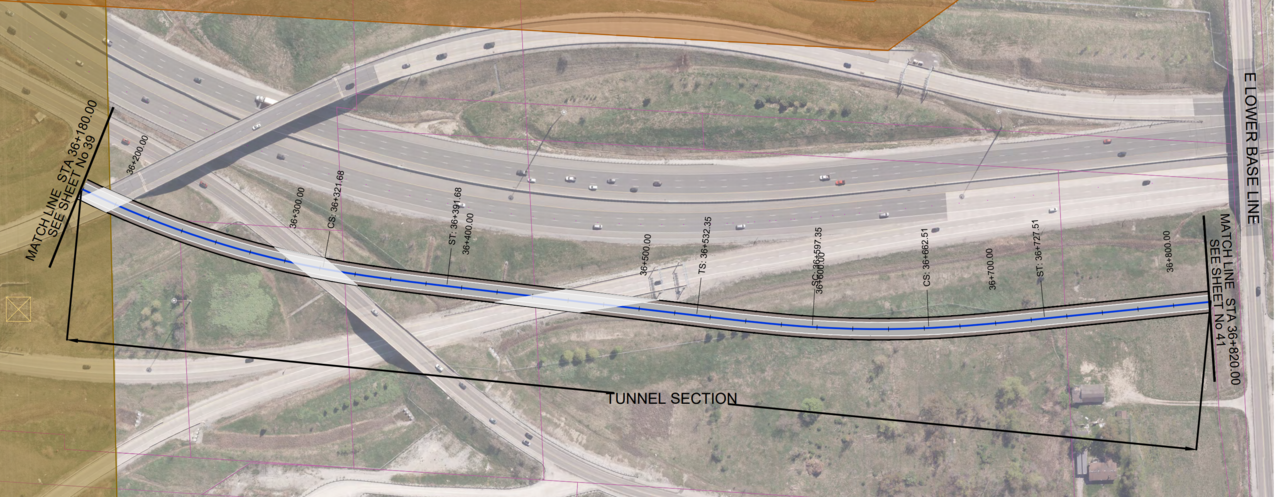

The EPR also shows tunnels going under the 403/407 interchange (I would imagine this would be cheaper to do as a big flyover? Seems unnecessary to tunnel):

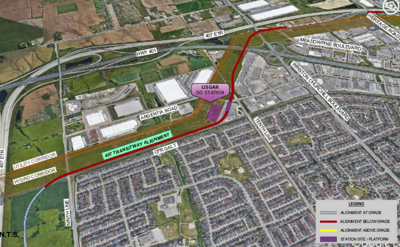

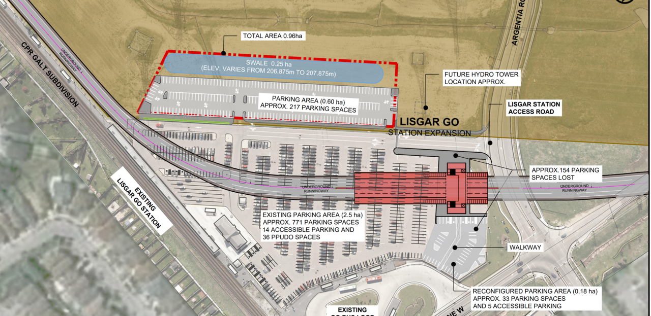

It also shows this extremely long BRT tunnel under the hydro corridor to get to Lisgar GO, as well as what looks to be a horrible connection at Lisgar (A York U Busway type solution would be way cheaper, but I guess that's up to Hydro One. If Hydro One doesn't allow, I'd imagine the Lisgar connection would be deleted if and when this is built, just like the CCTT station on the Mississauga Transitway)
Both of these long tunnels are described as "A combination of cast-in-place box tunnel and bored tunnel with active ventilation" on pg 31.
Hopefully these things are improved if and when this thing is built since these tunnels would be insanely expensive and don't seem super necessary, and that Lisgar GO layout really sucks (well, at least it's better than what's proposed at Bramalea lol, but still bad)

Can't all the tunnelling west of Lisgar GO be replaced with just running it on street on Argentia? All you'd need is a short underpass either on or west of Ninth Line. At the very least, that area won't have any stops and could easily be widened to add dedicated bus lanes.
