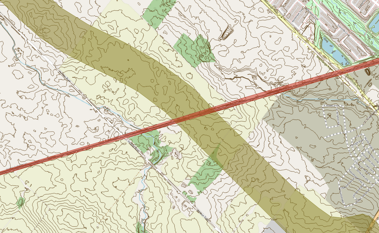

Able to map that?
bafkreihtvzd5a2hbz4tplnkbycww3uemse37g74bicdovolvsrn6m6bpea@jpeg
This was a draft from quite a few months ago. The red is rail lines, the tan is the 413, based on the EA drawings.
Here are some details that might be needed to sell the 413 idea to CPKC.
- Where does the bypass cross the Halton Sub? Over? Under?
- How does the bypass cross the ML Heritage Yard?
- What gradients are proposed to climb from 200m elevation at Hornby to 270 m at Mississauga Rd, and from McLean Rd (240m) to CP Mactier Sub at Vaughan (200m)??
- How much curvature is required to dodge the higher elevations between Hornby and the CP Mactier Sub?
- What is the total mileage vs current?
- How many river/creek crossings are required and what's the total required meters of bridgework?
- How many grade separated crossings? How many level crossings?
If one is going to draw lines on a map, let's use a topographic map, and start assessing the challenges therein. It all looks good on a highway map, however.......Just because a highway is able to be built on that alignment, does not prove that it's a good routing for a railway line. Or even affordable.

You beat me on a number of things you posted.
1: Drawing lines on maps is easy if you have no idea what has to happen or can it happen to run CPKC along that line.
2: Ford and others can say the line will be built, but have they asked CPKC if they are willing to use this new line that will as deal with extra travelling time along getting in/out of the Agincourt yard?
3: Ford has to pickup the full cost for any new CPKC line alone buying the land, rebuilding existing overpass/underpass and building it. Then there are grade separation that will be required where none exist today or will be needed,
4: How does CPKC come off the Galt Sub and get pass CN Halton Sub?
4: Its a known fact that CN does not want CPKC running on their tracks nor interfering with their yards. They also want a buffer zone between the 2 systems.
5: How does this bypass cross ML Weston Sub to run along the southside of CN Tracks? This also includes CN Loop track from the Halton Sub to ML Weston Sub.
6: Railways prefer to use 1% or less for grade, but have used up to 2% when they cannot get that 1% grade.
7: If one view that plan route as an aerial view, you will noticed a lot of issues meeting CN needs as well dealing with Hydro corridor. Every bridge over or under the widen rail corridor will have to be rebuilt to handle the new 4 track corridor along with a few new grade separation crossing.
8: how does CPKC get over CN in the east as well getting to CKCP Agincourt yard??
9: What do you think these new lines will cost to build it as well how long do you think it will take??
10: Do some real site visit where possible to see what the line may look like, starting from existing overhead overpasses or areas where there are underpasses as well grade crossing. I have done a lot of this over the years when I had time to do it and not a simple project.
It is far cheaper and faster to upgrade CPKC Galt Sub line at $2.5 Billion as phase 1 without doing some expropriation to electrify the line with some issues in the Streetsville area because of CPKC yard.
Phase 2 requires a lot of work along with a number of grade separations, new bridges with a higher cost doing it. To electrify the line will be a major issues for most of the line,

Trying to tackle this best I can. Numbered them for ease.
1 - East of Heritage Road. Given the close proximity of the two creeks and groundwater issues the would likely stem from an underpass, I'd say it'd go over.
2 - It doesn't it's to the east.
3 and 4 - I have to come back to this, I haven't finished running contours for Etobicoke Creek watershed and areas west, plus I'd probably want to run a topo profile tool a few times and I've found it finicky.
5 - It's about 42km along the 407 / 413 corridor from Galt to MacTier. 413 would cross Galt at Mile 26.4, MacTier at Mile ~17.5 (West Toronto Jct is Mile 4.9). So that's about 20km / 12.4mi shorter for Galt-MacTier traffic. Can't say what it's be to get over to Agincourt or the Belleville sub without a theoretical route, 413 ends the 400.
6 - This is tough. The West Humber and Etobicoke Creek watersheds are headwater areas for the 413, so the crossings would be piddly, or (more likely) the province already is planning on some drainage works to modify this. I would say a dozen or less between MacTier and Brampton's north border. Besides that, the Credit River is the only other notable watercourse, but granted it is a huge 800+m valley there.
7 - 31, though 6 of them are at 3 intersections. 1 is a rail crossing. None would be at grade if you're building a highway me thinks.

Counterpoint to this is the 413 corridor has an average width of 330 metres, which is much greater than others. I'd imagine a chunk of this is elbow room for grading and drainage works, but nonetheless suggests there's way more room than necessary.
Just so we're clear. The 413 proposal would have the tracks running parallel with the 413. Not down the center of it. If that changes anything...
Either is certainly possible to consider as a starting point. My gut says that a center median rail line would be cheaper and easier to design and build, but possibly not to operate. I don't have data to support that.
I can't help but trigger to @Metroscapes observation that the 413 corridor is uncommonly wide - rubs a bit of salt in the wound - ie this highway will swallow a ridiculous amount of land that is better left as it is. But that may be water under the bridge, if today's election goes as the pollsters claim, 413 is a done deal. Using some of that land for a rail line does salvage something good out of the plan.
