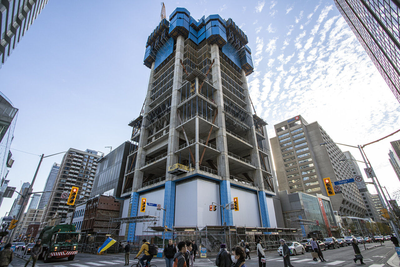

Some samples, at near-annual increments - first shot is Oct 23 2020, second is Oct 23, 2021, third is this past Friday, Oct 21, 2022
View attachment 434489View attachment 434490View attachment 434491
Pictures like these make me appreciate how far this project has come, albeit slowly. Living in the area it seems like just yesterday it looked like your first pic! I'm proud that such a unique and high-quality building is being brought to the area.
