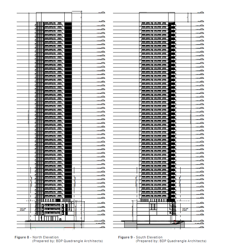

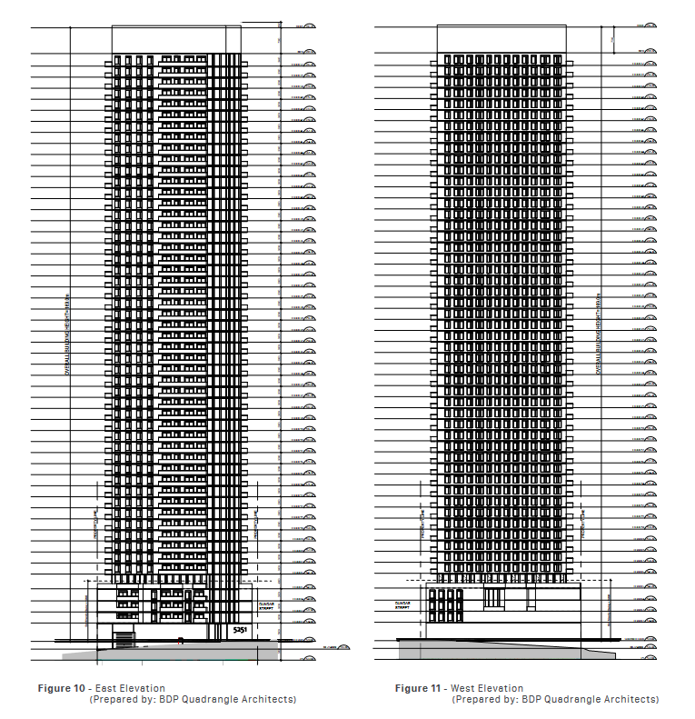

Oh........and *Docs are Up*
Architect is BDPQ

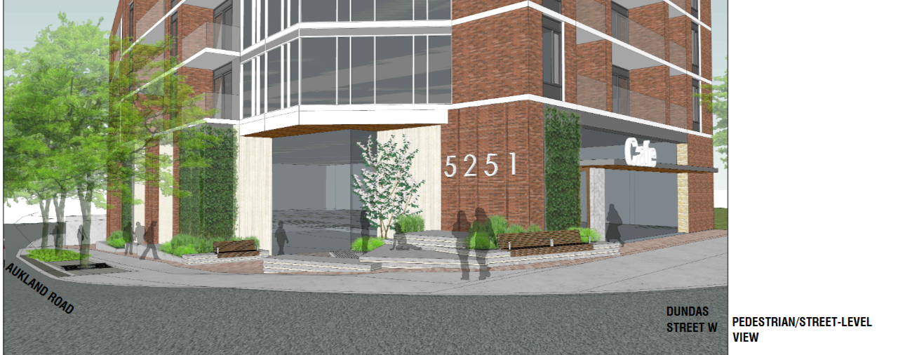

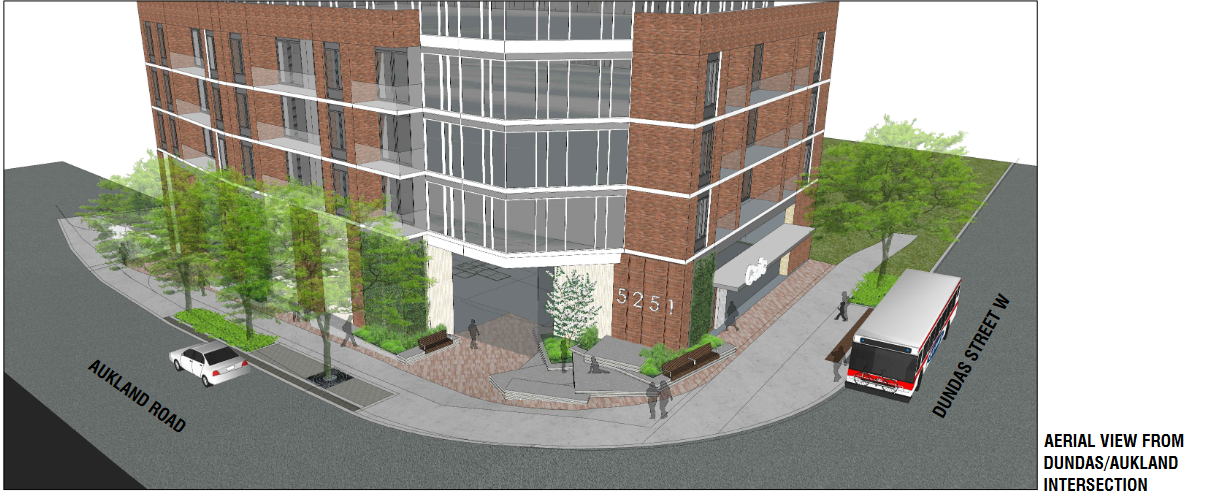

There's only one free-floating render in the package:
* I found some additional renders inside the Landscape Plan.....but they appear somewhat different to the one above:
Speaking of the Landscape Plan, it's not bad............
