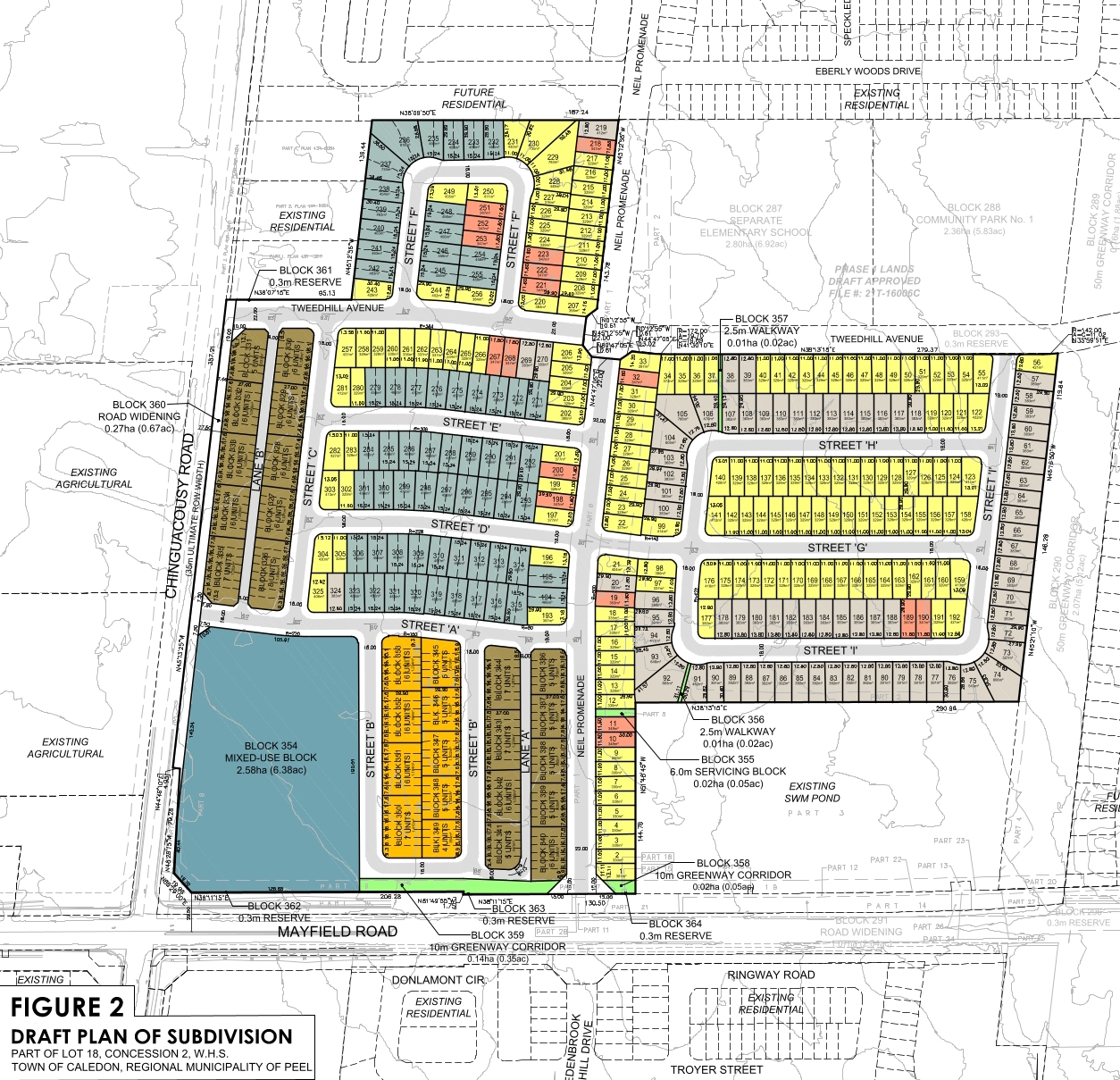

Plan of subdivision from the submission package:

Not even the pretense of urbanism with the garages out front rather than using a laneway system.
Street grid isn't very grid-ish, it's very anti-pedestrian/cycle.
Streets A and I; and E and H need to be tied together across the entire site so as to shorten travel distances for those walking or biking.
The N-S section of street I should be a bit more centred in its block and push through to Tweedhill.
"Existing SWM pond?" Very, very odd, Caledon. Just move to apps, like everyone else!
Their use of "Trails" is more "interesting" ...as it doesn't look like anything there that a pedestrian would want to travel through on their way to smell the roses.
