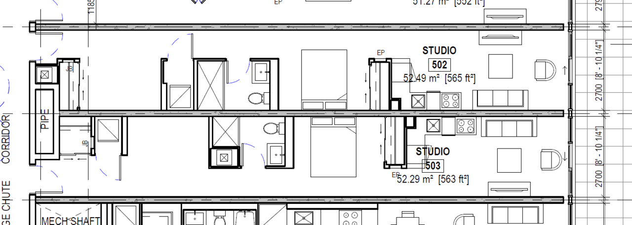

Ehh, the interior would be pretty dark but it looks like it’s actually a pretty functional unit, plenty of space for clear eating, dining, sleeping, and office spaces .Definitely far worse out there.
8'10" wide unit. Even for a shitkicker like Brad, that's low.
What strikes me............8ft 10, minus 6ft for the bed provides an unobstructed travel path (assuming one didn't obstruct it) of 2ft 10.
In general, an unobstructed travel path for someone in a wheelchair is considered to be 1100mm (or 1.1M) which is 3'4.
While its true that only 15% of new units constructed are required to meet accessibility standards...........and in respect of kitchens or areas a guest might not use, perhaps that's reasonable.
I'm not sure its reasonable that someone in a wheelchair may not be able to visit a resident at all; or be able to used the bathroom, at all, if visiting.
I would argue, at the minimum, this unit width is six inches shy of reasonable.
The bed doesn’t need to go end-out, it can be put sideways which creates a wider aisle.
Again, it’s definitely not a great unit, but it’s far from the worst getting built today.
