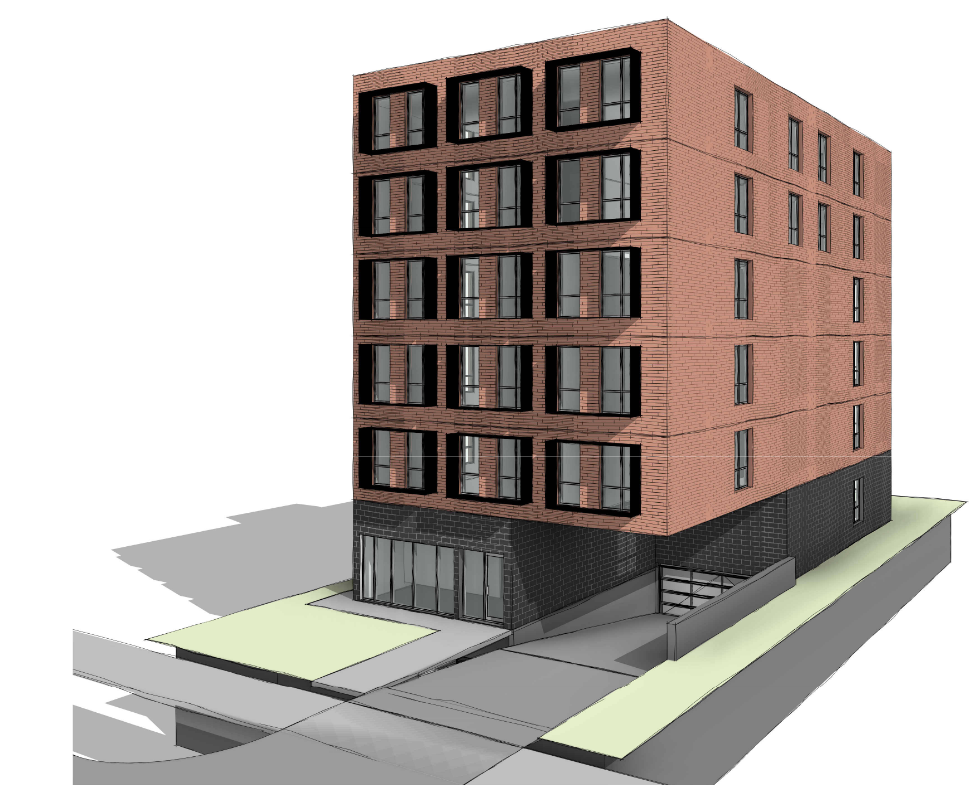

This new to the AIC proposal seeks to replace an SFH with a 6 storey apartment building fronting Bloor.
The site as is, per streetview:
The app:

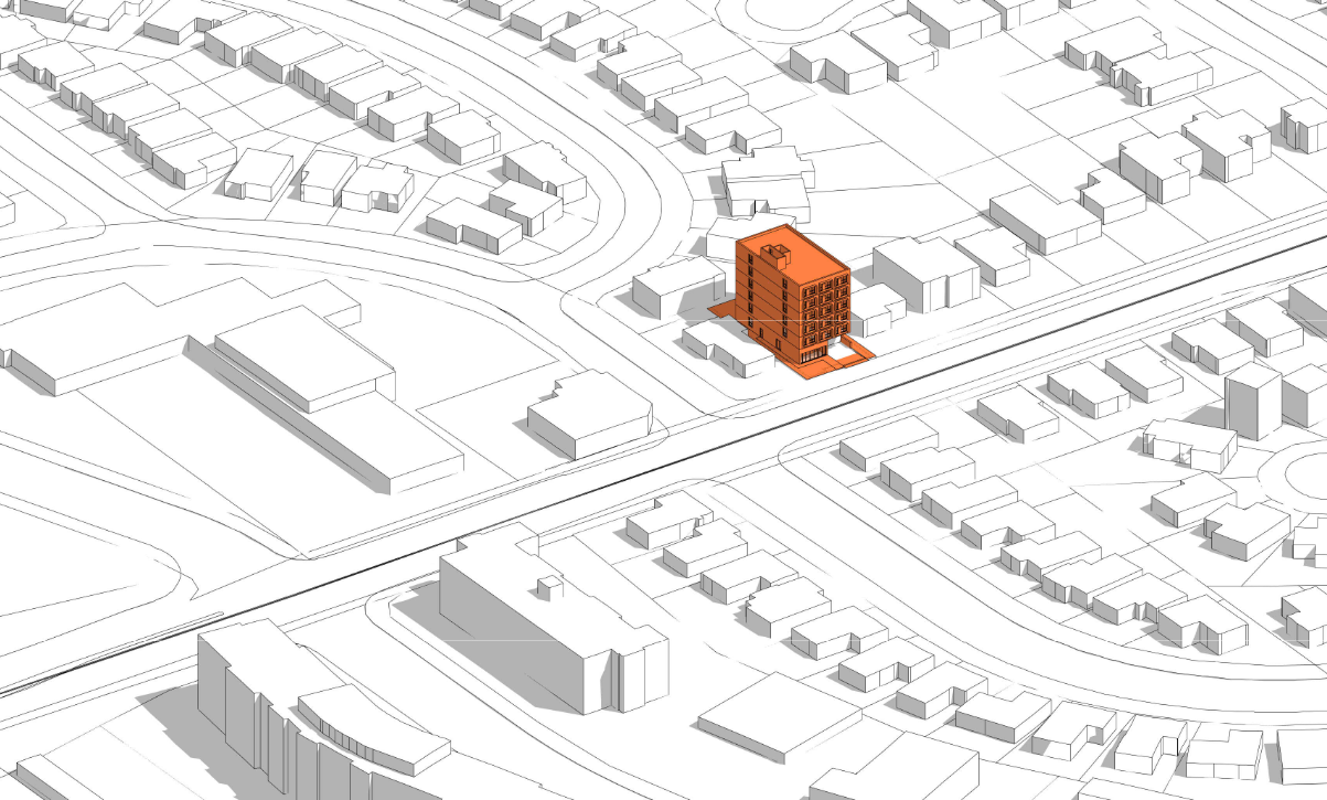

Aerial Perspective:

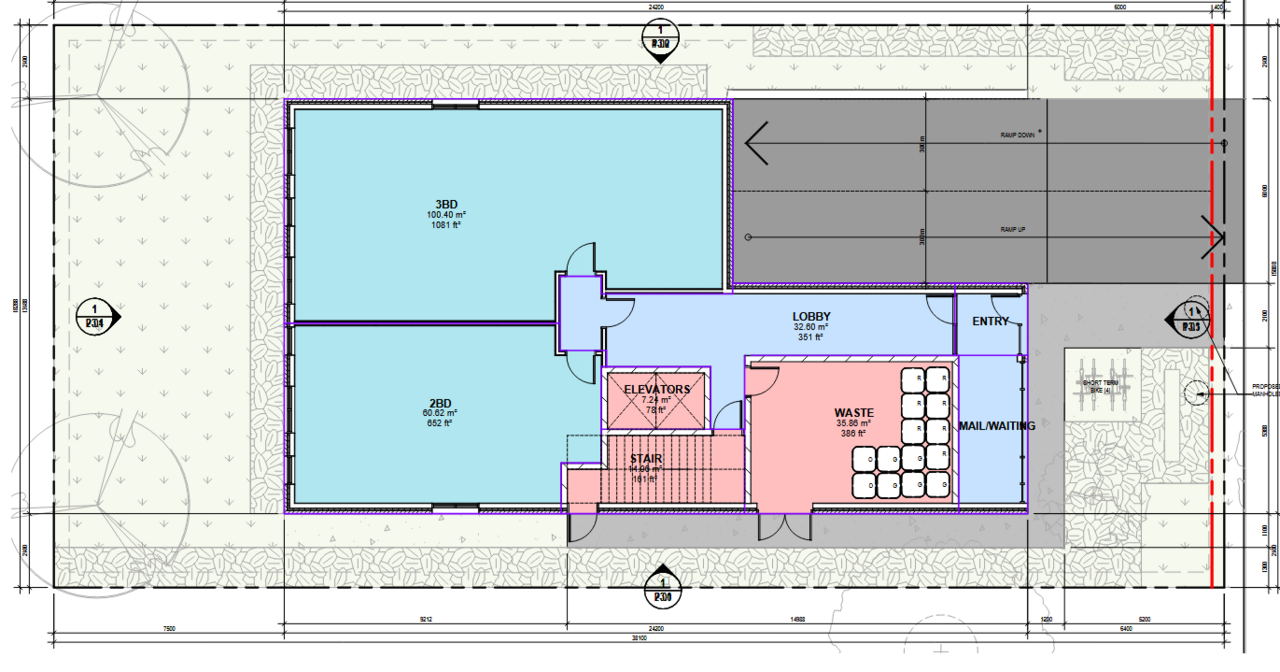

Ground Floor Plan:

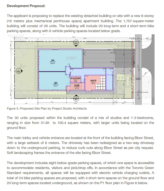

Description:
Elevator Ratio: 2 elevators to 28 (or 30 units depending on which doc you reference) 14 or 15 units per elevator
