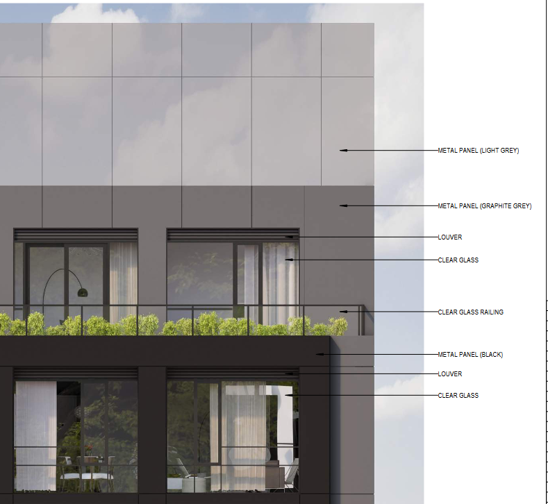

Comments: The scale is inoffensive. Unfortunate that it appears a very large tree will have to be removed. Architecturally, it's not terrible, but it's a bit of a sore thumb. A bit more contextuality in the expression would not be a bad thing.
That said, it's basically supportable. They may see a bit of push back on the street wall, easily addressed by dropping the setback down 1 floor. The height of the mechanicals seems excessive on this building, it's out of proportion.
Minor tweaks I'd like to see, ever so slightly boost the proposed ground floor height such that the mid-point between floors 2-3 aligns w/the roof next door and lose the ground floor overhang and deep inset on the entrance, it doesn't fit w/the neighbouring builds.

While I actually like the design, it looks a bit half-baked in terms of the layout. I know it’s only 30 units but there is no garbage room or place to store bins, and no loading area which could be problematic being on Queen St (there is no laneway or access to the rear of the property). Having only just the front access for retail will be a pain too, depending on what kind of business will occupy there.
More than half of the units are studios, maybe combining them into larger units will ease these shortcomings and improve on the interior layout, but I expect more changes in this building as the property changes hands.
