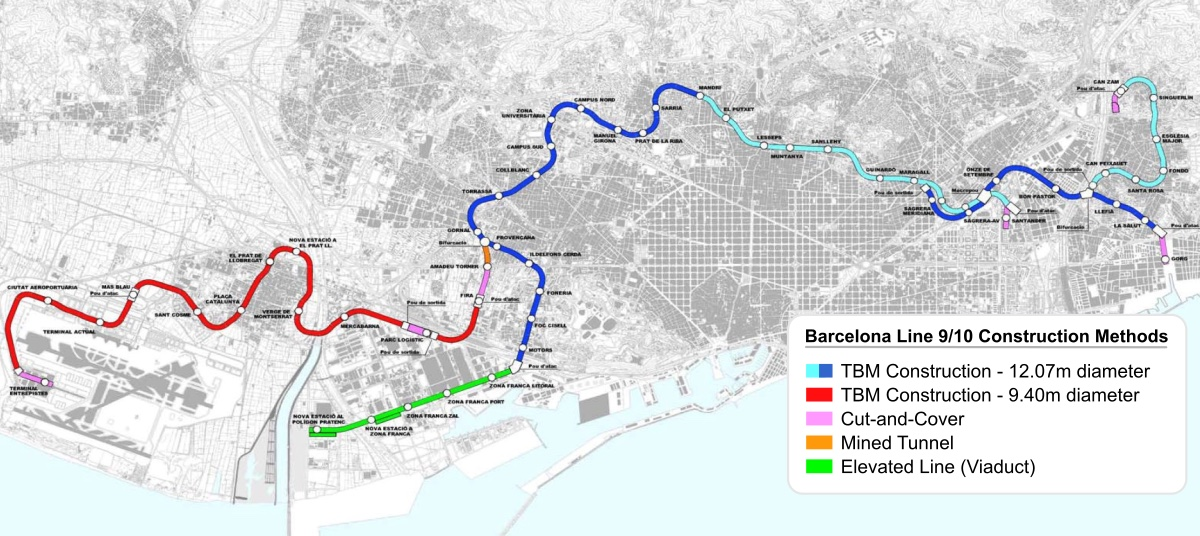

I saw this study from UofT today, and I think it's pretty relevant.
PDF: UNDERSTANDING THE DRIVERS OF TRANSIT CONSTRUCTION COSTS IN CANADA
Some key quotes, IMO.
Risk and NIMBYs:

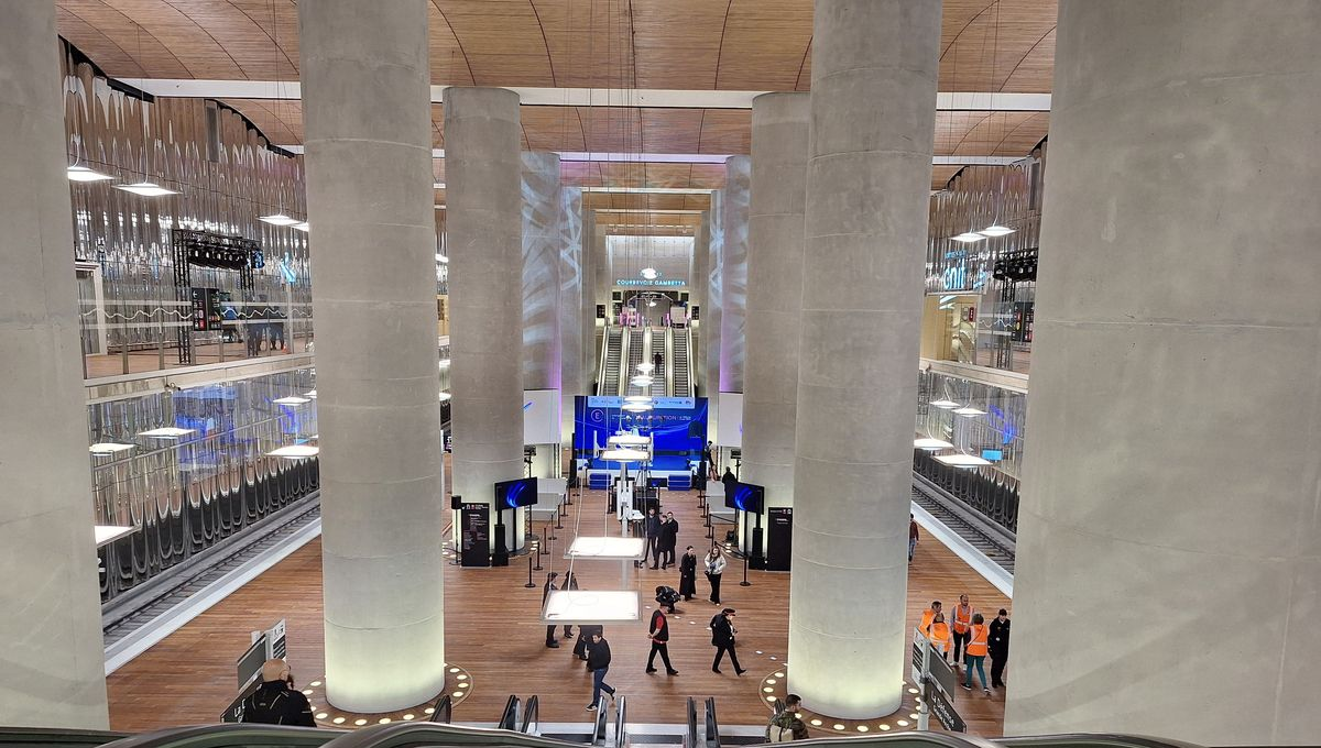

Canadian transit agencies tend to overbuild in multiple ways, with larger and deeper tunnels and stations – a result of greater risk aversion.
(something something fire standards, which I understand is controversial)
The second aspect of risk aversion that is in play is letting external stakeholders drive design. To build political support and avoid the risk of litigation, many Canadian transit agencies allow external stakeholders (e.g., community groups, municipal governments, and business interests) to extract concessions from transit projects.
Methods:
Alignment selection: Low- and medium-cost jurisdictions minimize the use of tunnelling (e.g., by selecting elevated, at-grade, or trenched alignments) and reuse existing rights-of-way within project alignments wherever possible. Where tunnelling is strictly needed, low-cost methods (like cut and cover) are prioritized over more expensive methods (tunnel boring or mining).
Station depth and size: stations make up the largest proportion of hard costs ... Low- and medium cost jurisdictions reduce unnecessary back-of-house space and build underground stations as shallowly as possible. Where deep stations are absolutely necessary, the volume of excavation is minimized by eliminating full-length station mezzanines, or maintaining access exclusively through elevators.
Standardization: Low-cost jurisdictions standardize within a given project, and also implement national guidelines and best practices for design and construction. This lowers not only hard costs (through economies of scale), but also soft costs, since the burden of design and engineering work can be reduced.

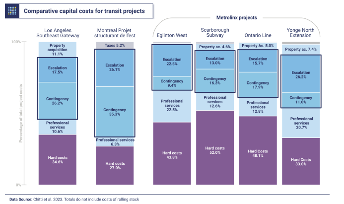

Risk:
However, excessively large contingencies can lead to “budget laxism,” where the incentive to control costs over a project life cycle is low and money, having been allocated, is unnecessarily spent.
The Metrolinx cost percentages in Figure 7 illustrate a habit of loading budgets with several layers of contingencies. The Metrolinx cost percentages in Figure 7 illustrate a habit of loading budgets with several layers of contingencies. Not only is project risk accounted for (“contingency,” 19.3%), there is also allowance for the risk of inflation (“escalation,” 13.7%). All told, risk provision accounts for 33% of the budget –more than the total soft-cost proportion of the Italian cases (9%).
the way Canadian agencies perceive and manage risk is at odds with the concept of contingency itself. Theoretically, contingencies should never be entirely spent, and should shrink as project risks are managed through the design and engineering process. However, the continuously escalating per-kilometre costs in Canada indicate a persistent trend of overpadding, where budgets are regularly inflated due to 1) prescriptive risk management practices and 2) the absence of resistance to increasing costs.

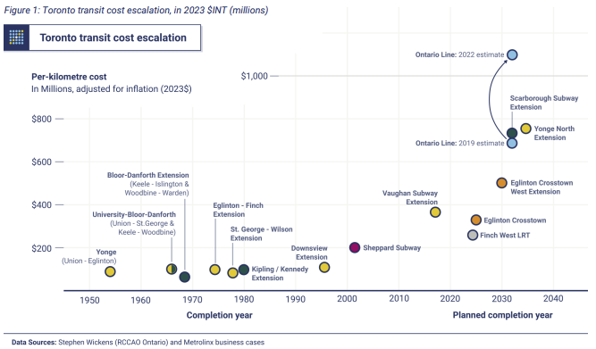

And some graphs. Cost history:

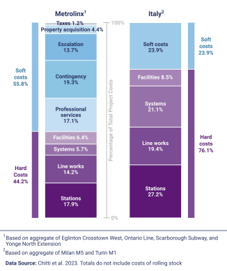

Metrolinx vs. Italy:
Contingencies:

Excellent post. I have bookmarked the study for some light reading later.
Let me blow a couple of those slides up so that people can more easily read them:
Reactions: PL1
No budget for escalation (i.e. inflation) in Italy? is part of it possibly to do with different accounting practices?
I mean look at Ontario - ECWE and YNSE are phased purposefully to be completed later with spending drawn out further, so their escalation costs are substantially higher.
Escalation is inflation, not real dollar impacts.
Fascinating paper!
Likely. TTC and early Metrolinx never included inflation in the budget. Simply that the numbers were in something like $2010. It waas always understood they'd be higher based on inflation.
I'm curious at what inflation rate was used in the calculations on that graph from 1950 to the current. Often people mistakenly use the Consumer Price Index - which reflects all sorts of bizarre stuff, like the move of production from Canada to Asia (etc.). This suppresses the inflation rate.
It would be interesting to see what that graph would look like if one used the local Construction Price Index instead. The Construction Price Index has exceed the Consumer Price Index for decades - massively at time. Personally, when I'm doing costing I tend to use 3% for the consumer price index, and 5% for the construction price index. While 3% might be a bit conservative (rate too high), 5% is (if anything) too low for many periods! But people start freaking if you take the last 10 years, and project it on the next 10 years! :)
Perhaps a question for @Stephen Wickens.
