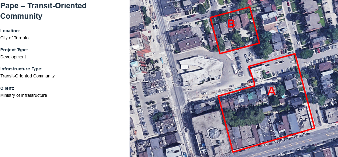

Site Area(s) for the above:
The lower portion 'A' encompasses the entire block east of the condo proposal at the corner, all the way to Eton, and a portion of the Green P lot to the north.
Site B is 7-15 Gertrude Place, but oddly does not show the balance of the Green P, and also excludes 5 Gertrude for no obvious reason that I can see.
Streetview from Gertrude:
Everything from the 1s white bungalow to the left is included, but the 2s house setback to the right is not.

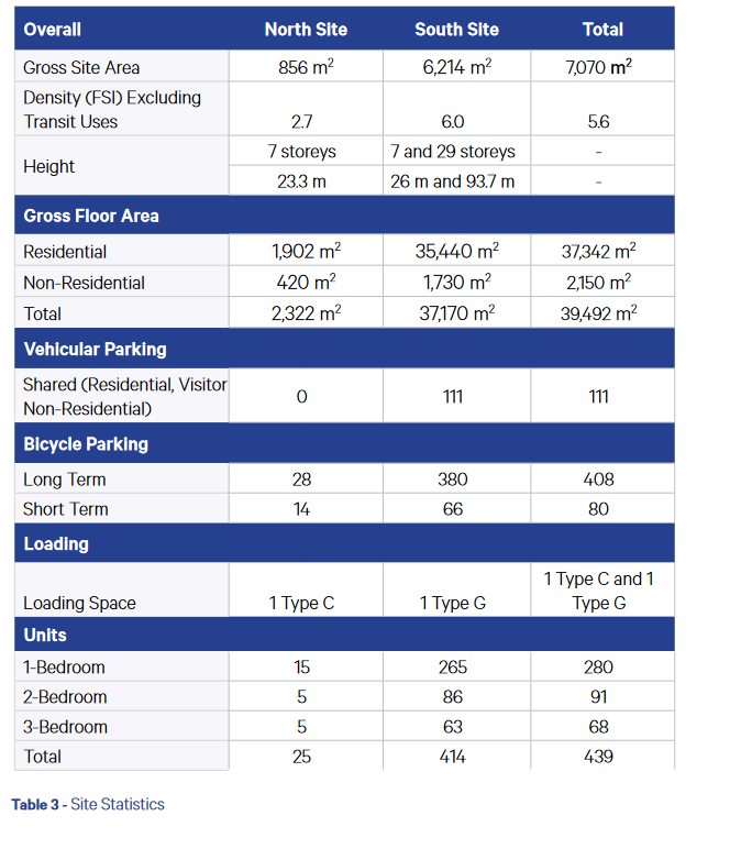

1) While there is no dedicated parking for residents, there are 3 levels of 'shared' parking, underground. I'm not sold on that, unless there were larger format, destination retail on the second level above grade, but there is not.
2) As @innsertnamehere notes above, this proposal envisions the Green P lot remaining * (to be clear, I think Green P is looking at this one as having development potential and/or serving as the park for what's around it; but that should be sorted now to optimize the development plan, not done ad hoc.
3) There is no large format retail (ie. a supermarket) contemplated on the second floor here, or underground, which I think should absolutely be considered, there is only one small Foodland nearby, which is great, but wholly inadequate for the incoming density.
4) For the elevator file: 5 elevators over 414 units. Unusually generous. 1.2 elevators per 100 units.

Edit to add the Site Statistical Summary:

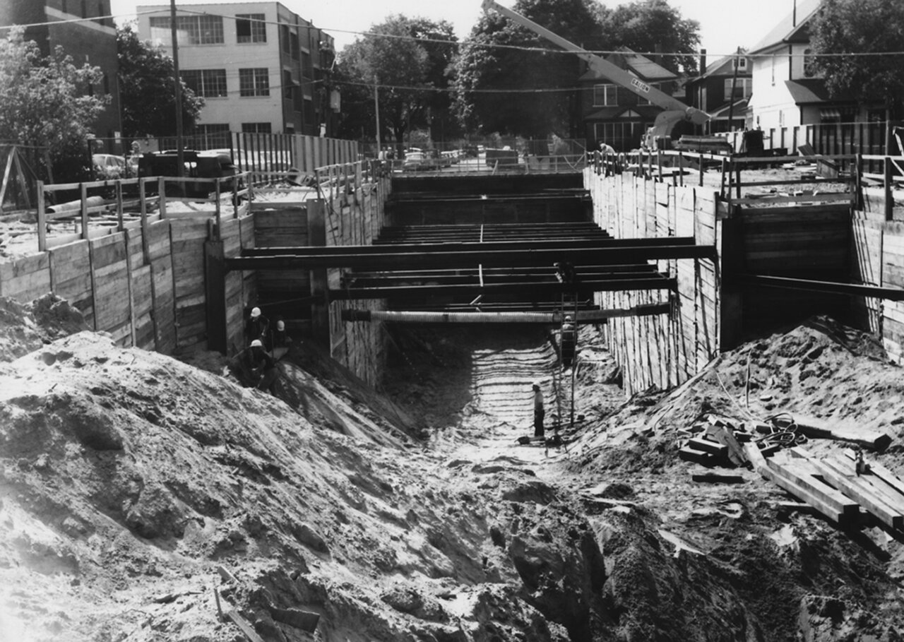

the most upsetting part of this is them leaving the Green P lot atop the subway as-is.
…because of how shallow the 1960’s cut and cover Subway tunnels are running just north of Danforth. The parking-lots and parks are just about all those tunnels were engineered to support above them.
This image is of the tunnel depth between Main and Chisholm. That stretch of the line is very shallow.
Similarly shallow tunnels can be found just east of Yonge from north of College to north of Bloor, and these have increasingly been built over; one 'simply' puts the structural supports for the building on the outside of the tunnel, and then builds a new deck over the top, which could replace the existing tunnel roof, but that isn't strictly necessary.
There is an added cost to that, which certainly impedes lowrise forms. But this was done for a mere 17-storey tower that currently sits atop the Line 1 Bloor platform. It can be made to work if the value of the new build is there.

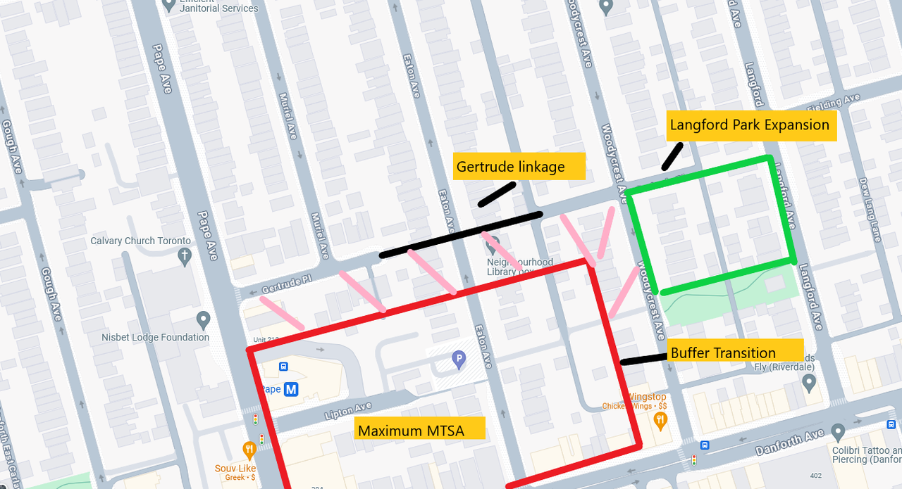

On that note, my proposal here:
Create an enlarged area of density (outlined in red); buffered by a transition zone in pink.
Extend Getrude to Gertrude to be the new 'hard line'.
Pool all area parks funds to turn the existing Langford Park (over the Line 2 tunnel) into a real park of useful size to meet the new needs the community and to act to buffer the higher density from lower to the east/north.
