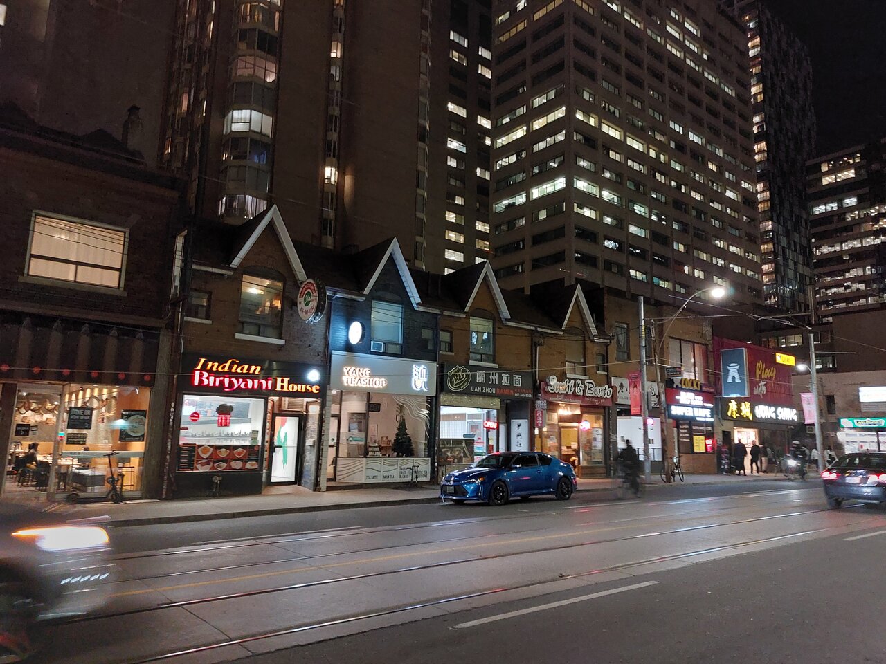

Night time view of the current buildings on this block:

For this location, this design is terrible! Where's the inviting walkable character? A combo of moving the lobby up and having some retail/restaurants on the second floor would help a lot. I actually really like 2nd floor restaurants - great for people watching!

I don't see why they can't have an engaging street scape environment with multiple small scale restaurants and a tower in the back. We need to house the influx of people to the downtown but not at the cost of sterilization...
Edit: Yes I'm suggesting they have a rethink of the ground floor layout and how it interfaces the street. I little additional effort here could have a real positive impact...
You absolutely can achieve that; it's merely that this proposal as designed does not achieve that.
