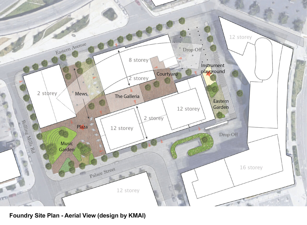

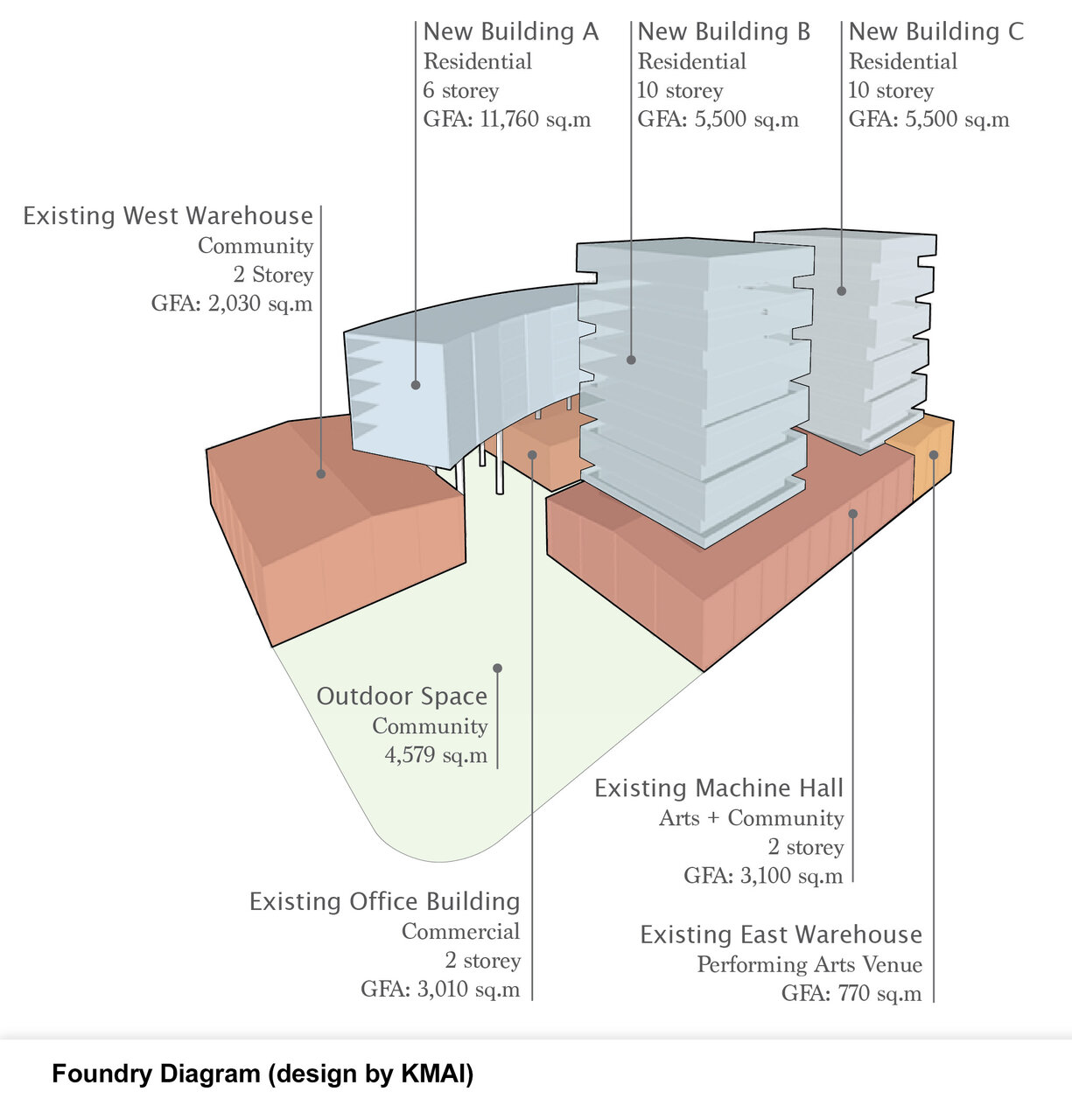

IRCPA releases their plan.

Good design and use of the site, but the two 12 storey buildings should be considerably taller to enable more affordable housing. Also wondering a bit how the indoor space in the Machine Hall and in particular in the East Warehouse where they propose a performing arts venue would work with the structure and foundations of the two buildings above coming down right into the middle of them.
agreed on the height. it seems they were pretty strict about not wanting to supercede heights of neighbouring buildings. i believe the intention is that the machine hall is converted to building lobbies, cores, and some storefronts, and the east warehouse and west foundry are retained.
Looks great, but I can’t imagine the province scaling down the project to this extent. Especially considering they were planning 250 affordable units and this plan only has half that number. The only way this flies is if the province sells the land to the city.
the reality is that each of the residential buildings need to be 5-10 stories taller.
And there is nothing wrong with it being 5-10 stories higher, especially if it meant the heritage structures will be preserved.
Cute images, sure, but why would you put the 'towers' over the star building? You'd lose all of the open air beauty of the main hall. This doesn't really take actual building science into account in any way.
I supposed you could give them C for effort? But still...those two buildings need build in away to minimize their footings to maximize space in said building. And that admittedly is likely a bit tricky as currently shown, to put it mildly.
...that said, it does demonstrates a much more forward thinking in how to preserve those buildings than is offered by our current Provincial government.
Interesting concept, especially the curved building on stilts and the way in maintains the mid-block connections, but the density is unrealistic. I agree, it seems to me you'd want to keep the atrium of the main building and put a tower where they have a park. Given the amount of public green space nearby I don't think a park is necessary.
agree with the height, these should have substantial height to have a fighting word in all this. I thought the same thing in that the towers seemed odd over the main machine hall. However, it does allow you to preserve much of the open space on the site which is nice. It's not a dissimilar approach from what happened at Distillery; tower jutting out of a small footprint 1-storey brick warehouse.
Yeah, you have a ton of green space at Corktown Common and lots of sitting/relaxing space on Front. Can the park and build a tall tower there. It's the only spot in the area where you don't have to worry about shadows!
