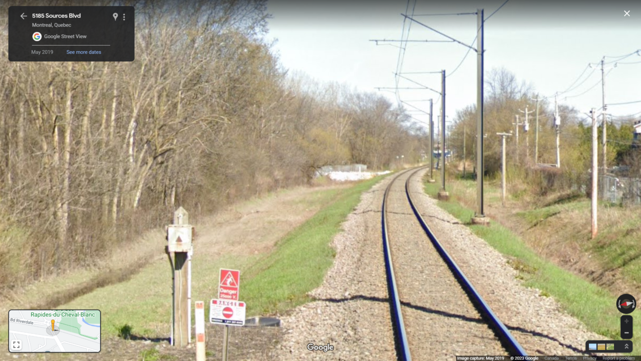

That's like... your opinion man
I think catenaries look quite nice, shots like these especially feel really pleasant to look at
How quaint. A single rail line. A mainline railway at that, so not even relevant. You guys don't need to show Prague, or Montreal. We have tracks and wires all over Toronto. And now we have an elevated guideway, with catenary, it's on Eglinton. Why not show that considering the relevance to the topic at hand?
I like catenary. Our mainline commuter system needed it decades ago and is well overdue. As does the chugalug airport diesel that was supposed to have it. And an LRT, intermingling with people and cars, yeah how else is it going to get power. But a subway, separate from people and cars. Third rail is a winner. Saves money, looks better, greater flexibility.

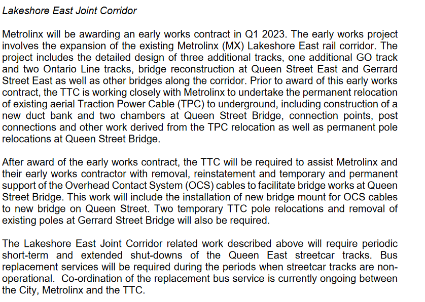

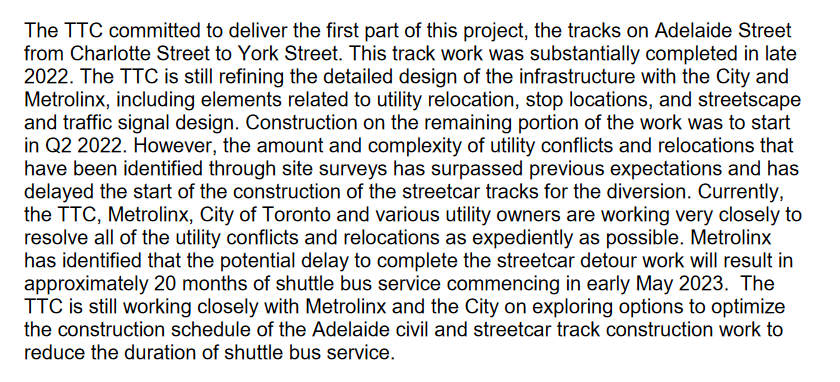

soo the 501 is going to be pretty much toast for next few years.. fun ! ... and then of course once this is done .. then the ttc will prolly need to tear up the tracks for renewal . :rolleyes:
I fail to see the difference in visuals. I like Catenary in trenches, I like catenary on viaducts. Those elevated viaducts in Melbourne and Sydney look really nice.
Also the OL tunnel, if it didn't have catenary, should save about 16,000 dump trucks of dirt that has to be hauled somewhere.
