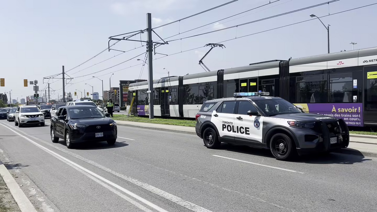

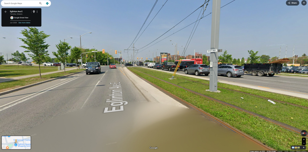

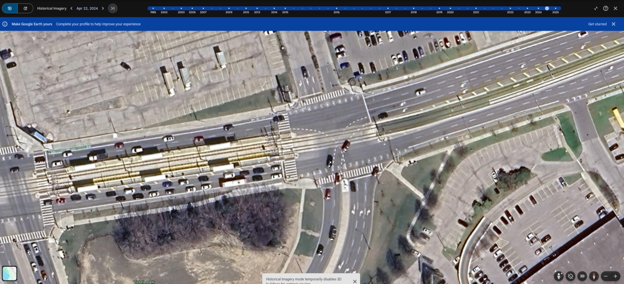

Assuming the LRV didn't move much afterwards, based on the image from CP24 and from using Google Street View the collision seems to have happened at the eastern edge of the intersection of Eglington Square and Eglington Avenue
View attachment 672308View attachment 672309
This intersection currently has pedestrian crossings at all edges except for the eastern one
(Had to use Google Earth because Google Maps is very out of date)
Obviously we need to wait for more details to confirm but it seems possible to me that they were crossing along this edge when they were hit
The solution to me would then be to add a pedestrian crossing to this side of the intersection
I also feel in general it is silly to leave one side of an intersection without a crossing though
Thanks for the imagery. See there is no place to stand between the roadway and the tracks. The grass and concrete mixed ROW does add confusion.
There are fencing along some parts of the ROW where elevation differs between the tracks and roadway. They should extend that to the entire golden miles stretch where jaywalking is common.

On the CP24 coverage of the incident, they mentioned that in the time the police were there, several pedestrians appeared to be crossing across the tracks and the police had to tell them not to go near the LRV or on the tracks.

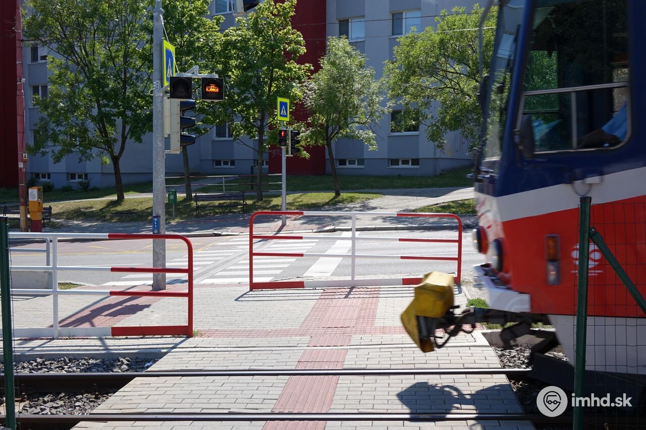

I would much rather we discouraged jaywalking by designing the infrastructure correctly, i.e. with an appropriate amount of crosswalks, and safety zones to prevent people from blindly walking forward:
Or even what they do in Kitchener-Waterloo, where there are gates and audible warning signals that sound when a train approaches. Putting up a wall would just make an already pedestrian hostile landscape more unpleasant to traverse.
