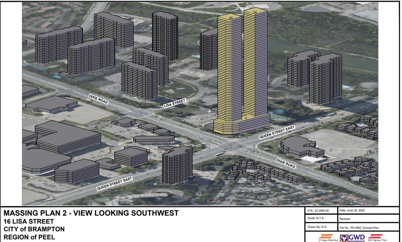

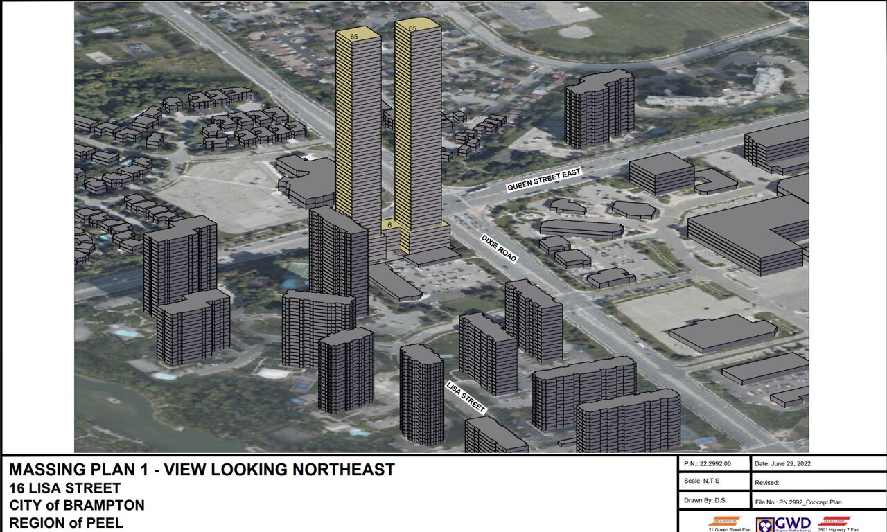

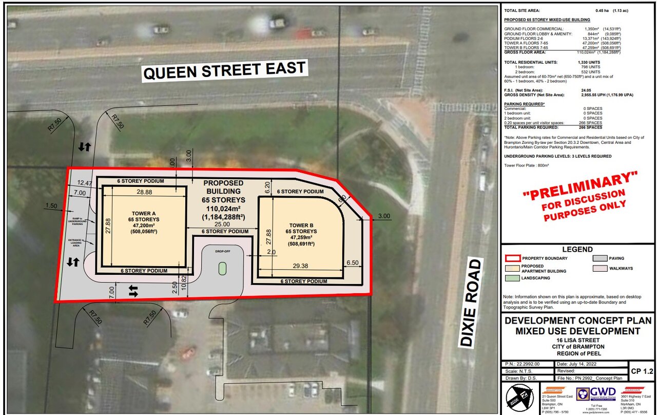

Early pre-consultation submission for two 200m 65-storey towers at the southwest corner of Queen Street and Dixie Road, on the site of a retail plaza (the official address is 16 Lisa Street). This is across the street from Bramalea City Centre, which is also in the pre-consultation stage for partial mixed-use redevelopment.
I suspect that this is just a planning exercise, put an early concept plan and massing study has been made public.
Site Area – 0.45 hectares
Number of Storeys – 65
Ground Floor Commercial – 1,350m²
Ground Floor Lobby/Amenity (Floor 1) – 844m²  
Gross Floor Area – 110,024m²  Tower Separation above Podium – 25.0 metres 
Units – 1,330 (1B – 798, 2B – 532) 
Floor Space Index (FSI) – 24.05 
Average Tower Floor Plate – 800m²

As mere massing, there isn't much to critique but it's certainly a very dull massing, no real contour.
I don't see that its disproportionate height to the tallest thing around by material multiple is warranted either.
Great site to redevelop, great site for residential intensification and density; but needs to be commensurate with the proposed BRT and not a subway that isn't there, and isn't coming.

This development is so comically tall that even More Neighbours Toronto people find it excessively tall, it should be more like 40 storeys to keep it in line with the Bramalea City Centre redevelopment
