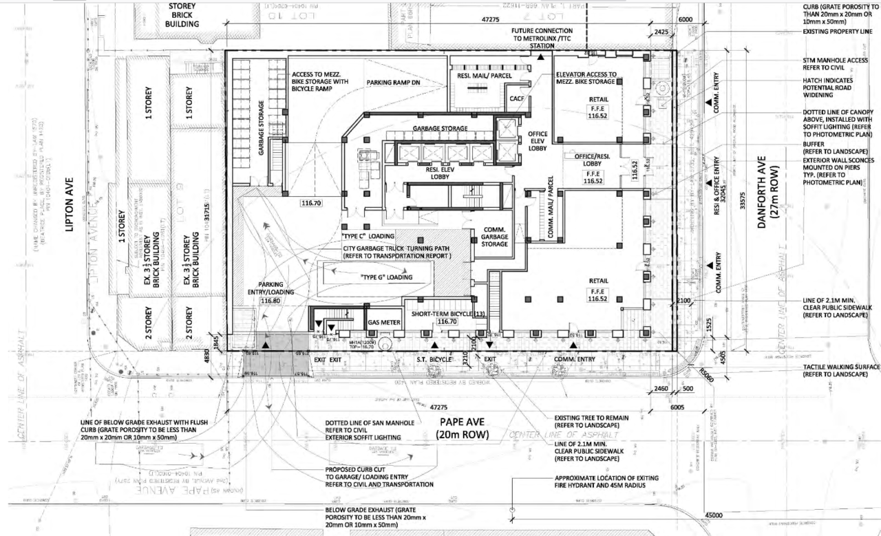

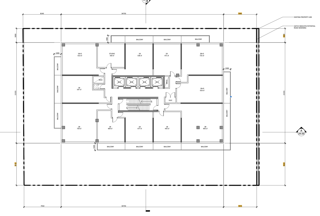

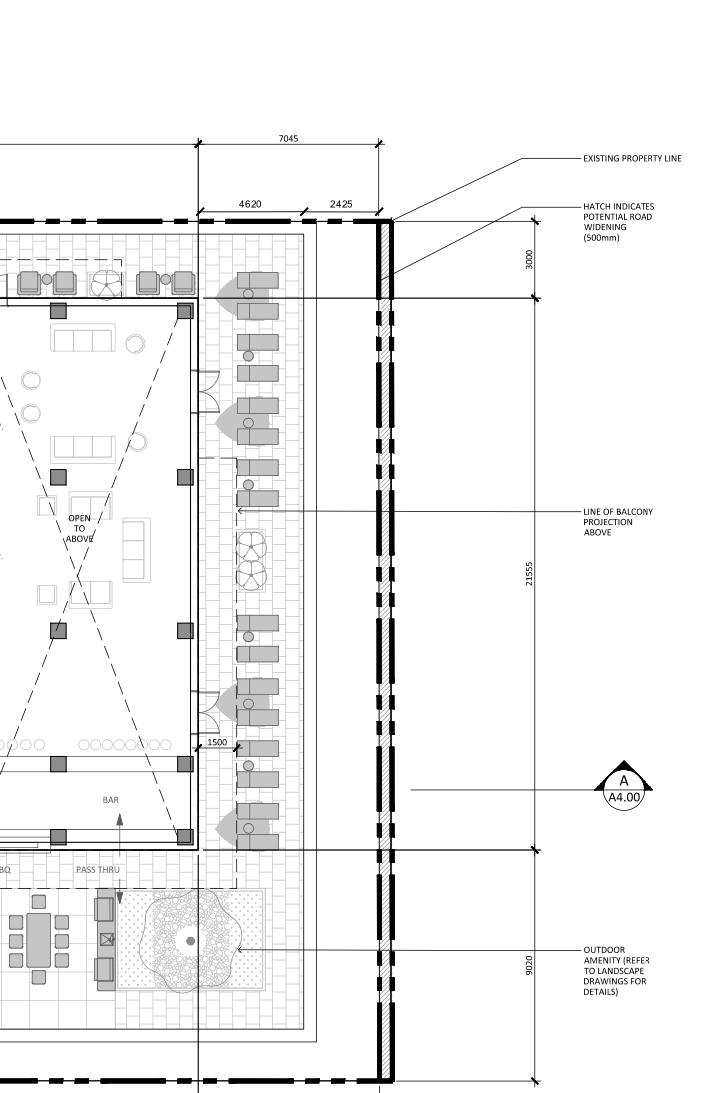

The setback to Danforth property line is 7.045m (inclusive of balconies) or 5.545m exclusive. The setback from the podium on Danforth is 4.6m (inclusive of balconies)
The setback to Pape property line is 9.020m (inclusive of balconies) or 7.520m exclusive. The setback from the podium 7.495m (inclusive of balconies)

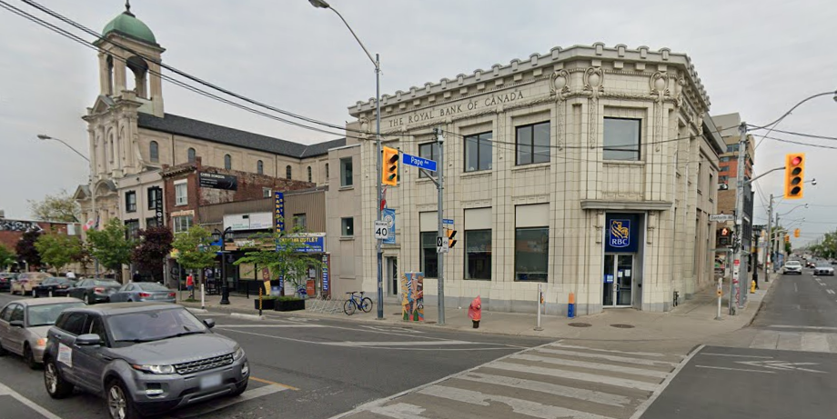

Lets leave the nice, heritage-listed Royal Bank on the north-west corner alone shall we.
The south-west corner, which includes the former Odeon Danforth (now Good Life Fitness) is very much in play.

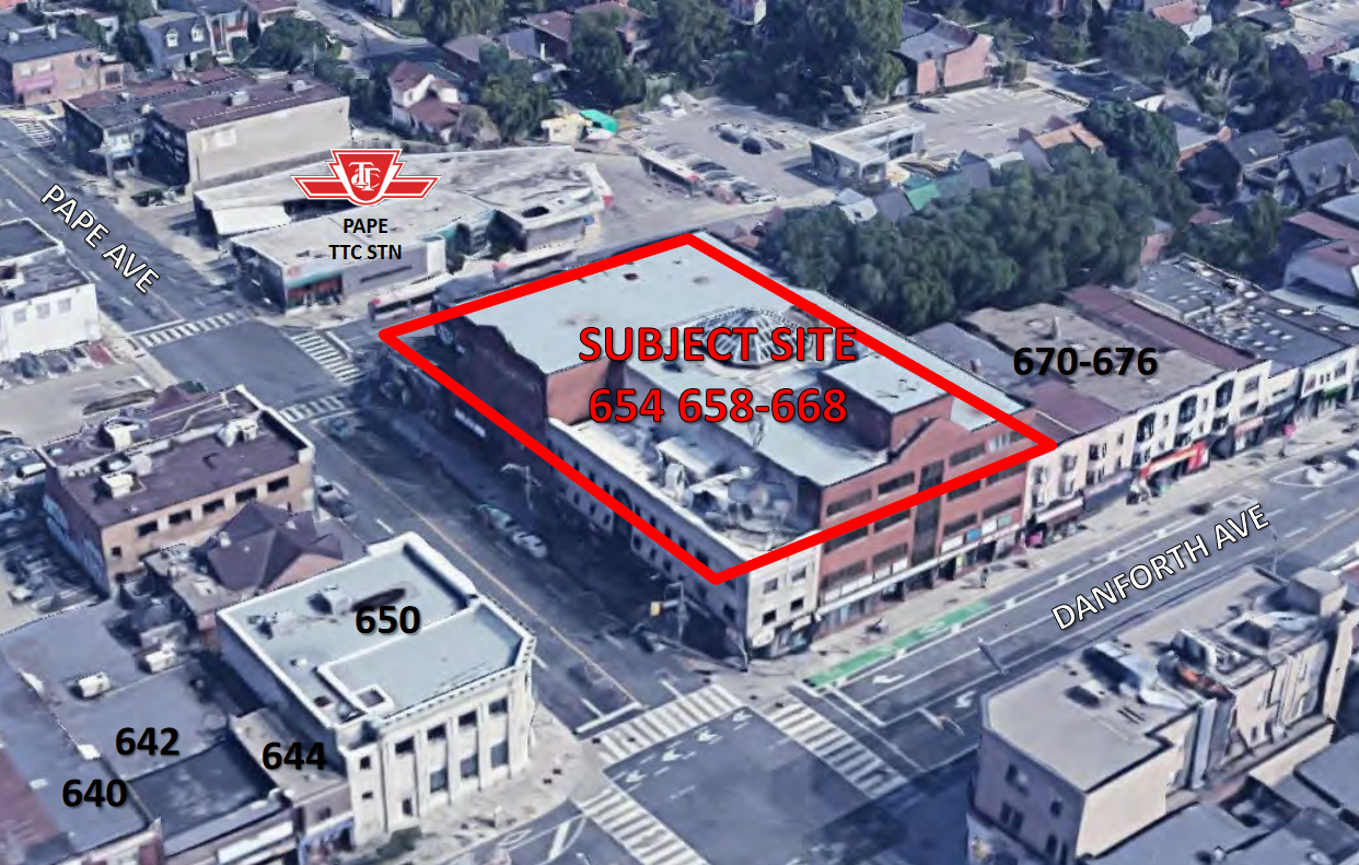

Did someone say something about intensification on Danforth? Well..............
This is the site of a current medical office building; but was formerly the Palace Movie theatre.
Site as it is today (Aerial view from the Planning Report)
Architect is Studio JCI.

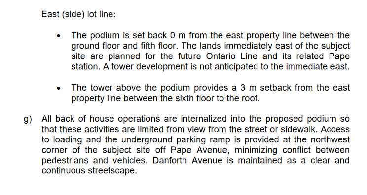

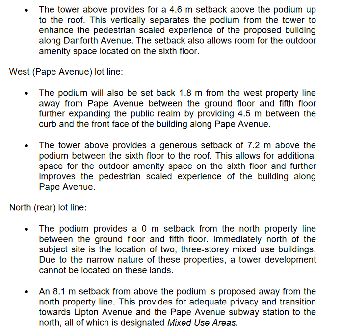

From the Planning Report:
* note the proposed connection to the subway/OL station.
