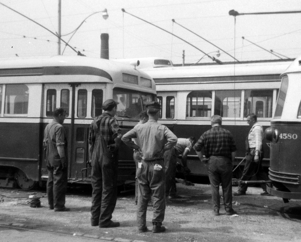

Roncy wasn't always paved. Here's 1968. Note the more advanced snow clearing technology of the day,.
