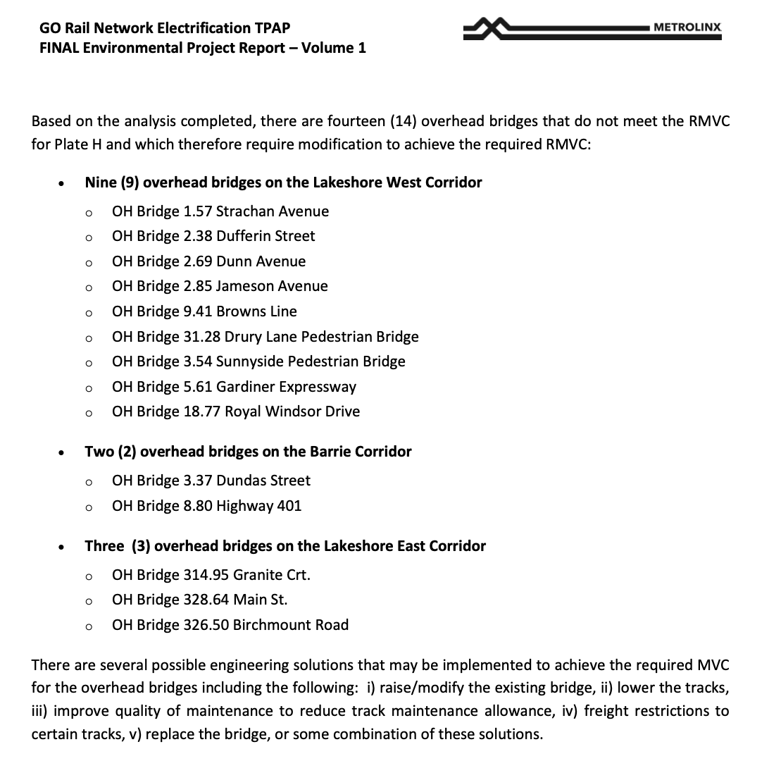

Now, getting those low bridges on LSE/LSW fixed is another matter...
This appears to be the plan. Whether the trainshed is altered or not will not prevent ML from wiring up the new south platforms for LSE/LSW ahead of electrifying other routes.
Would the fix the bridges themselves or slightly lowering the grades? I think I remember a report from years ago that I may still have that spoke to what would need to be done. Maybe I can look it up.
My recollection is some of Collumn A, and some of Collumn B,
Here's one study for Dunn/Dowlling, no mention at all of electrification - which would undoubtedly impact on design.
PS Dufferin
PPS - Considerable bridge by bridge discussion in the Electrification EA beginning at page 147ish of the EA Report, Volume 1
PS Dufferin
Can we ask if the required change(s) are strictly clearance levels for wiring, and if so, do we have the data on those problem clearances as well? All of this is a problem. However the issue in meters is one thing, cm's may be another.
