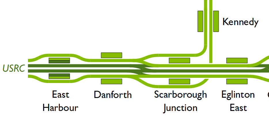

Most of the cost and complexity of the Danforth Station reconstruction is due to the cancellation of the Scarborough Junction grade separation. If Stouffville and Lakeshore had a combined corridor with express and local tracks, they could just put the fourth track where the island platform currently is, avoiding the need to change the south side of the pedestrian tunnel.
This may be a dumb question, but if all the preparation for a fourth track in the LSE corridor occurred north of the current tracks how does adding a new south platform/track to Danforth GO align to the fourth track?

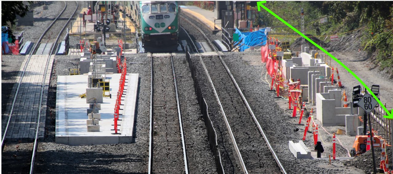

Long Branch with more up on my site
The area under the tracks is totally dug out and excavating the area on the south side.

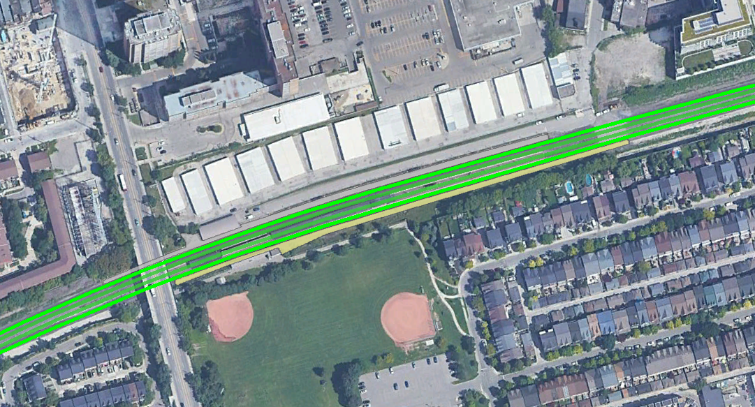

All that’s needed is to cut eack track and make a slight shift - Track 1 east of Danforth will be connected to the new north track, Track 2 east of Danforth connects to existing Track 1, etc
I can't remember. Are they also adding a 4th track here (green annotation on @drum118's photo)? cc @smallspy @crs1026 @Northern Light @reaperexpress
They're not adding a 4th track or platform as part of the current project. I hope they're protecting for one at least, I haven't noticed one way or the other.
This is another case where it would have been cheaper for them to build the station for quad track with two side platforms (same as the old Exhibition layout and planned Park Lawn layout), avoiding the cost of that island platform on the express track used by trains that don't stop there anyway. The station is only 2km beyond the current end of quad track (just west of Mimico) so quad-tracking through Long Branch would be a low-hanging fruit for capacity and flexibility improvements on LSW.
They're not adding a 4th track or platform as part of the current project. I hope they're protecting for one at least, .
This is another case where it would have been cheaper for them to build the station for quad track with two side platforms (same as the old Exhibition layout and planned Park Lawn layout), avoiding the cost of that island platform on the express track used by trains that don't stop here anyway. The station is only 2km beyond the current end of quad track (just west of Mimico) so quad-tracking through Long Branch would be a low-hanging fruit for capacity and flexibility improvements on LSW.
Thanks. Where is the quad tracking west of Long Branch going to start again?
There is enough room to add a 4th track but require adding a bridge over the creek. If I am not mistaken, Browns Line bridge is either a tight fit for 4 tracks or need to be rebuilt for it as it been too long since I shot it and looked at it to say which is right. There is enough room for 4 tracks from Long Branch to Burlington. You can get 4/5 tracks to Aldershot that has to be share with CN.
Any 4th track west of Long Branch would start west of the creek to the point there is room for 5 tracks up to Port Credit
Badly right now, but you can see the space appear to the west of the station. Presumably they'll have to shift the tracks a bit to line up.
The ROW itself is over 40 metres-wide enough for 6 tracks, so it's not a real problem. And then widens more east of Woodbine, presumably because of the industrial there, and the old yard from Main to Victoria Park and CN/GTR's "quarry" lands east of Victoria Park, and north of Gerrard. (why extracting sand was called a quarry I don't know ...).
